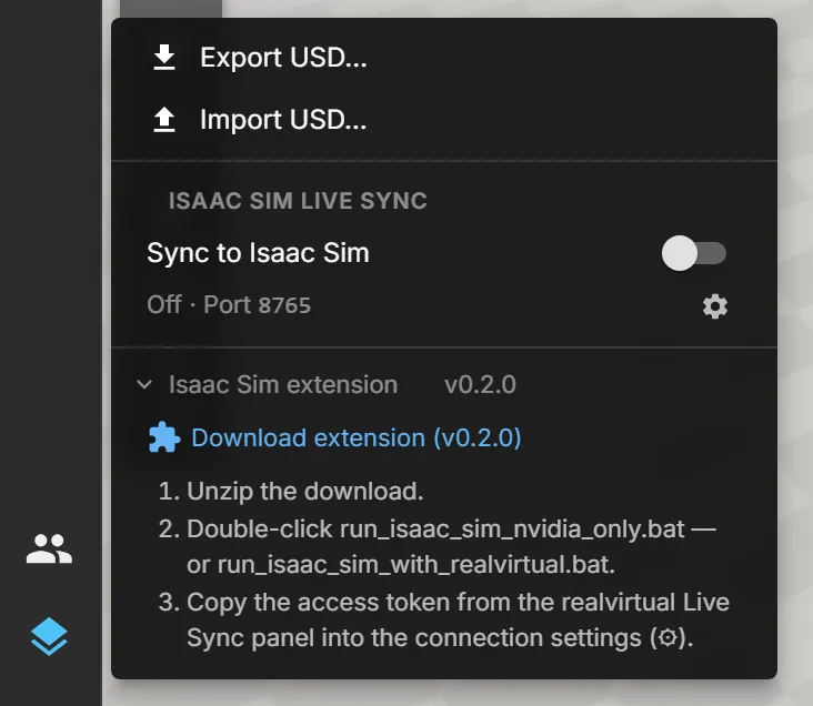

The button sits in the lower group of the left main menu, next to Problems and Multiuser. Its dot shows the sync state: green while live, amber while waiting, red on an error, no dot while sync is off.

Section titled “Set up the extension”- In the USD menu, open Isaac Sim extension and click Download extension. Unzip the file anywhere.
- Double-click
run_isaac_sim_nvidia_only.bat. It looks for Isaac Sim inC:\isaacsim,%USERPROFILE%\isaacsimor the folder in the environment variableISAACSIM_PATH, and starts it with the extension loaded — nothing is installed into Isaac Sim.run_isaac_sim_with_realvirtual.batdoes the same without restricting Isaac Sim to the NVIDIA card. - In Isaac Sim, the panel realvirtual Live Sync shows the port and an access token. Copy the token.
- In the viewer, open the USD menu, click the gear next to the status and paste the token.
- Switch Sync to Isaac Sim on.
The access token is created once and kept in %USERPROFILE%\.realvirtual\livesync-token.txt; New in the panel replaces it.
